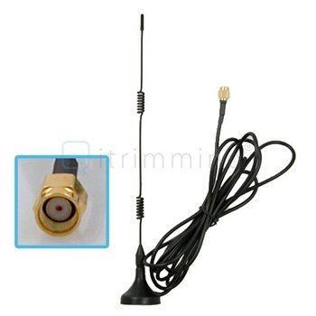

作者: margosa76    时间: 2009-2-13 11:39
比如这个,是不是网卡和路由器都能用啊?
# 5 X Range Extender - Extends up to 5 times the original range of your WiFi access in open space.
# Magnetic Stand design for easy to install on window side or top of the vehicle to gain more signals
# Frequency: 2400-2483 MHz
# Impedance: 50 Ohm
# VSWR < 1.5 Average
# Maximum Input Power 50 W
# With 2 meter pigtail and with SMA plug (Without pin inside)
# 9 dBi gains
# Omnidirectional Antenna
# Polarization Vertical
# Plug directly into your D-link DWL520, Linksys WMP11, WET11, Netgear MA311, or D-link APs (anything that uses Reverse Polarity SMA)
[ 本帖最后由 margosa76 于 2009-2-13 11:41 编辑 ]

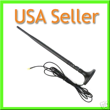

接头能有个特写么?
作者: margosa76    时间: 2009-2-13 12:53
这个能看清吗?
原帖由 bobwu 于 2009-2-13 12:00 发表
接头能有个特写么?
[ 本帖最后由 margosa76 于 2009-2-14 01:32 编辑 ]
图片附件: CNOK5161A103_it_L.jpg (2009-2-13 12:53, 13.38 KB) / 下载次数 90263
http://www.nbclub.net/DISCUZ/attachment.php?aid=11340&k=ca59a189da6416088c00a975c7cc1c22&t=1793791761&sid=7Rc05Z
作者: bobwu    时间: 2009-2-13 13:01
原帖由 margosa76 于 2009-2-13 12:53 发表
这个能看清吗?
一般路由器都能用的.SMC接口吧.
